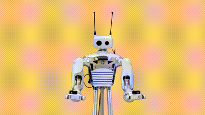

In this tutorial, we will make Reachy do the awake sequence, which is a series of movements that makes it look like it is waking up. It involves moving its head and arms and can be used as a starting point for more complex sequences.
What you will learn:
- How to make it move its head
- How to make it move its arms
- How to synchronize head and arms movements
