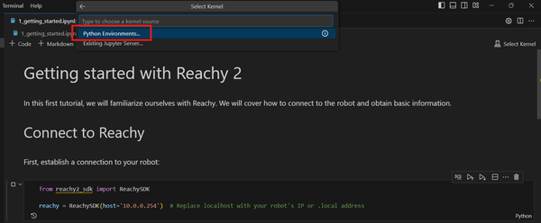

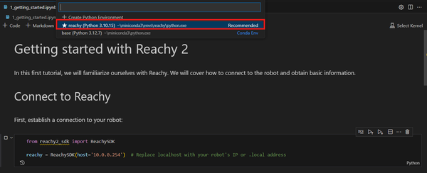

  4. Select the appropriate kernel:
    • Choose a Python environment and select your virtual environment.
    Select Python environment
    Select Reachy environment

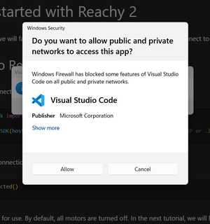

  5. Allow access if prompted by a Windows security popup:
    Firewall permission

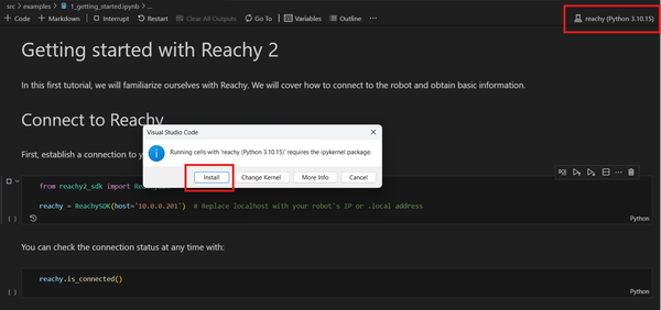

  6. Install the ipykernel package to run the notebooks:
    Install ipykernel
