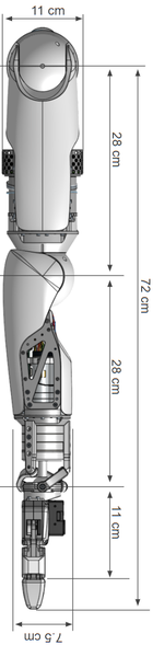

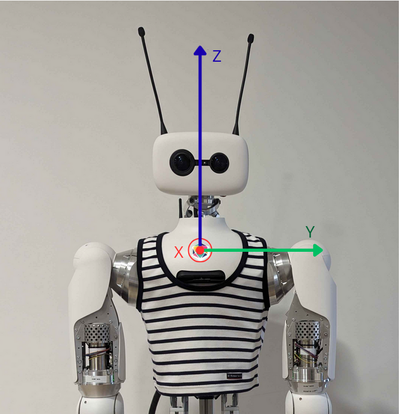

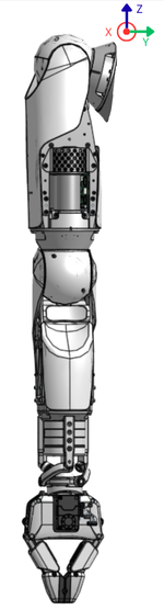

To use and understand the kinematic model, you need to know how Reachy’s coordinate system is defined (from Reachy’s perspective). See below:
Arm axis Arm dimensions
  • The X axis corresponds to the forward arrow.
  • The Y axis corresponds to the right-to-left arrow.
  • The Z axis corresponds to the upward arrow.
The origin of this coordinate system is located in the upper part of the robot trunk, inside Reachy. Imagine a segment from the left shoulder to the right shoulder—the origin is the midpoint of this segment, just behind the center of Pollen’s logo on Reachy’s torso.
Units in this coordinate system are meters. For example, the point (0.3, -0.2, 0) is 30 cm in front of the origin, 20 cm to the right, and at the same height.

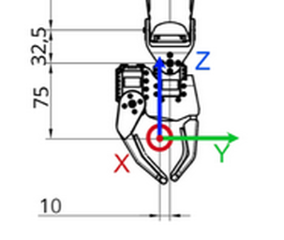

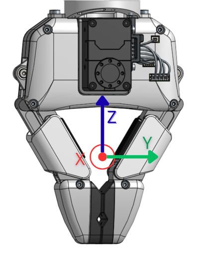

End effector location
The end effector is a virtual joint located in the gripper and referred to as ‘r_arm_tip’ or ’l_arm_tip’ in the URDF file, as shown below.
The red dot corresponds to the ‘r_arm_tip’. You can see the right and left end-effectors animated below.

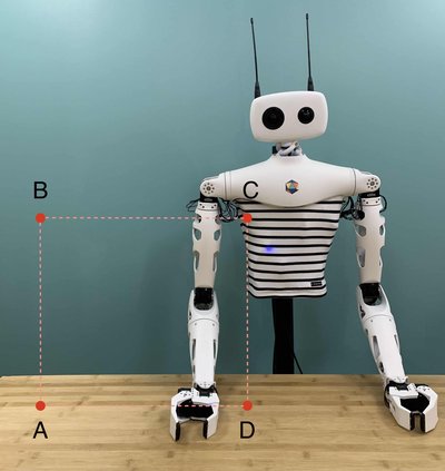

To make this more concrete, let’s first try with a simple example. We will make the right hand draw a square in 3D space. To draw it, we will define the four corners of a square and Reachy’s right hand will go to each of them.
The virtual corner is represented below.
For our starting corner A, let’s imagine a point in front of the robot, on its right and below its base. With Reachy coordinate system, we can define such a point with the following coordinates:
$$A = \begin{pmatrix}0.4 & -0.5 & -0.2\end{pmatrix}$$
The coordinates of B should match A except the z component which should be higher. Hence
$$B = \begin{pmatrix}0.4 & -0.5 & 0.0\end{pmatrix}$$
For the corner C, we want a point on the same z level as B, in the inner space of Reachy and in the same plane as A and B. So we only need to change the y component of B. We can take for example :
$$C = \begin{pmatrix}0.4 & -0.3 & 0.0\end{pmatrix}$$
And to complete our corners, we can deduce D from A and C. D coordinates should match C, except its z component, which must the same as A. Hence
$$D = \begin{pmatrix}0.4 & -0.3 & -0.2\end{pmatrix}$$

The result should look like this:
Goto square
