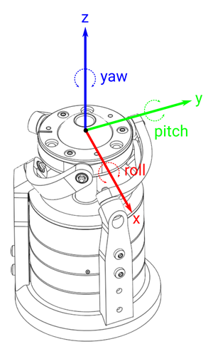

Reachy 2’s head is mounted on an Orbita3D actuator, referred to as the neck.
The complete head is composed of the following elements:
  • neck, a 3-degree-of-freedom actuator (Orbita3D) that controls the orientation of the head (pitch, roll, and yaw)

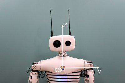

The look_at() method makes the head orient itself to face a 3D point, expressed in Reachy’s coordinate system, in meters. The coordinate system is the one we have seen previously:
  • The X axis corresponds to the forward arrow.
  • The Y axis corresponds to the right-to-left arrow.
  • The Z axis corresponds to the up arrow.
The origin of this coordinate system is located in the upper part of the robot trunk.

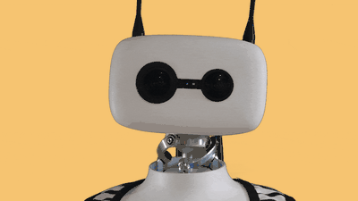

🦾 Example 2: Chaining look_at
Look at
Here is the code to reproduce this:
import time
look_right = reachy.head.look_at(x=0.5, y=-0.5, z=0.1, duration=1.0)
look_down = reachy.head.look_at(x=0.5, y=0, z=-0.4, duration=1.0)
look_left = reachy.head.look_at(x=0.5, y=0.3, z=-0.3, duration=1.0)
look_front = reachy.head.look_at(x=0.5, y=0, z=0, duration=1.0)
The best way to understand how to use the look_at() function is to experiment with it. Picture a position you would like Reachy’s head to be in, guess a point for the look_at() coordinates, and check if you got it right!

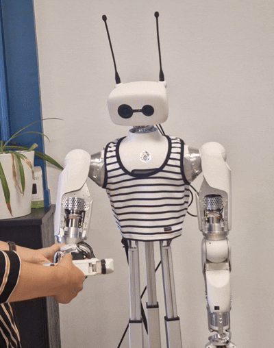

🦾 Example 3: Follow Reachy’s hand
Another cool thing is combining Reachy’s kinematics with the look_at() so that Reachy’s head follows its hand while you’re moving it!
Head following arm
x, y, z = reachy.r_arm.forward_kinematics()[:3, -1]
reachy.head.look_at(x=x, y=y, z=z, duration=1.0, wait=True)
while True:
    reachy.head.look_at(x=x, y=y, z=z, duration=0.1, wait=True)
This code calculates the forward kinematics of Reachy’s right arm. The x, y, z coordinates of Reachy’s right end-effector in Reachy’s coordinate system are used as the target for look_at(). The loop with a blocking movement (parameter wait=True) ensures the head follows the hand at a frequency of 10Hz.

You directly control the joints of the neck, giving the [roll, pitch, yaw] angles (in degrees by default). The rotation is performed in the order: roll, pitch, yaw, within the Orbita3D coordinate system.
