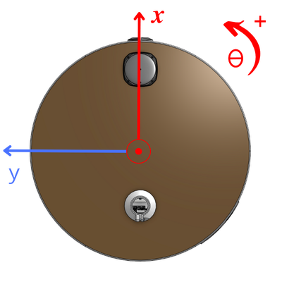

Robot frame
The robot frame, also called the egocentric or base_link
frame, is rigidly attached to the robot. Its (0, 0) point is the projection on the floor of the center of the mobile base.
X points forward, Y points left, and Theta increases counterclockwise.
It follows ROS’ conventions described in REP 105 “Coordinate Frames for Mobile Platforms”

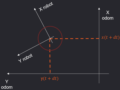

Odom frame
The odom frame is a world-fixed frame. The position (x, y, theta) of the robot in the odom frame is continuously updated through odometry calculations. These calculations currently rely solely on wheel measurements to estimate the robot’s movement. While the robot’s position is continuous, it should never be used as a long-term reference due to inevitable drift.
Resetting the Odom frame
The initial position of the odom frame matches the robot’s position at startup. The odom frame can be reset at anytime to the robot’s current position using:
reachy.mobile_base.reset_odometry()
After this call, the robot’s current position becomes the new origin (0, 0, 0)
of the odom frame.

Read mobile base position and speed
You can access the current estimated position and velocity of Reachy 2’s mobile base using the get_current_odometry()
function:
reachy.mobile_base.get_current_odometry()
>>> {'x': 0.0018306385027244687,
'y': 0.0533282645046711,
'theta': -7.456543983885954,
'vx': 0.0,
'vy': 0.0,
'vtheta': 0.0}
Position (x
, y
, theta
These values represent the estimated pose of the robot frame (base_link
) within the odom frame.
x
,y
: position in meterstheta
: orientation in degrees (increasing counterclockwise)
See the odom frame section to better understand how to read the position.
Velocity (vx
, vy
, vtheta
These values represent the instantaneous linear and angular velocities of the robot, but they are expressed in the robot frame (not the odom frame).
vx
: forward speed (in m/s, along the robot’s X-axis)vy
: lateral speed (in m/s, along the robot’s Y-axis)vtheta
: angular velocity (in deg/s, around the robot’s Z-axis)
See the robot frame section to better understand how to read the velocity.
