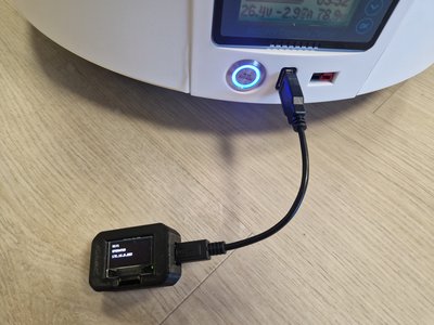

Option 2: Using the LCD screen
If you are not able to access the dashboard, you can turn off completely your robot. Then, you can plug the supplied LCD screen on the USB port of the mobile base.
Turn on your robot again, and it should display the robot’s IP addresses (alternately Ethernet and WiFi) :
