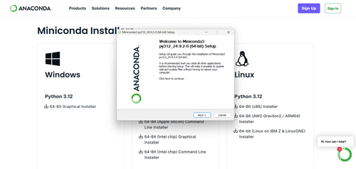

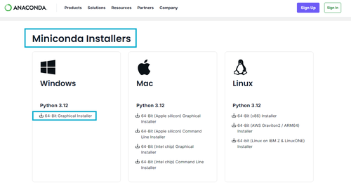

Use Miniconda, a minimal version of the Anaconda Python distribution. Download it here: scroll down to the Miniconda Installers section and click on the Windows installer.
Launch the
.exe
you just downloaded and follow the installation procedure.Open the Anaconda Powershell Prompt from your applications and type:
