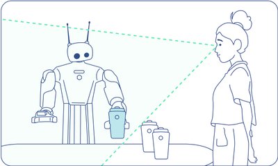

1) Be Vigilant
Be vigilant
Always keep your eyes on the robot while it operates.

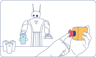

2) Ready to Stop
Ready to stop
Always be ready to press the emergency stop button in case of unexpected behavior.

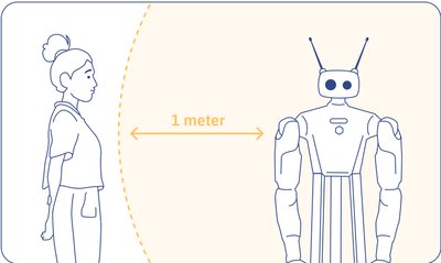

3) Maintain a Safe Distance
Maintain a safe distance
Keep at least 1 meter clear on all sides of the robot.

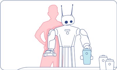

4) Avoid the Blind Spot
Avoid the blind spot
Never stand behind Reachy while it operates.

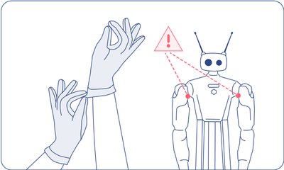

5) Wear Gloves
Wear gloves
Protect yourself from pinches when handling Reachy.

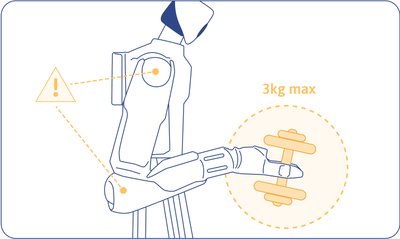

6) Stay Within Limits
Stay within limits
Never lift objects heavier than 3 kg or extend them too far.

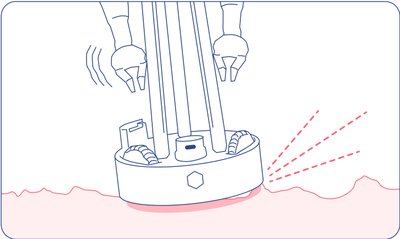

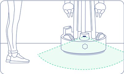

7) Mobile Base Safety
LIDAR Safety
Stay out of the robot’s movement zones to avoid collisions.
8) Stable Ground
Stable ground
Operate Reachy only on flat, stable surfaces.

  • Emergency Stop Button: Always keep a person ready to use the emergency stop button. Press it immediately if you lose control of the robot or notice unexpected movements. Objects held by Reachy may fall if the button is pressed, so ensure the workspace is clear of items that could cause harm.

  • Safety Bubble: Maintain a “safety bubble” around Reachy to prevent unintended contact or injury. This bubble should extend at least 1 meter on all sides during operation, with the exception of the front, where closer interaction is allowed for specific tasks. However, no one should ever stand or move within 1 meter behind the robot, as it lacks rear sensors to detect obstacles or individuals, increasing the risk of accidents, especially during teleoperation.

  • Pinch Point Awareness: When handling or manipulating Reachy, be cautious of pinch points between its joints and moving parts. To reduce the risk of injury, it is strongly recommended to wear protective gloves during any manual interaction with the robot.

  • Weight Limits: Never exceed the 3 kg (6.6 lb) weight limit when lifting with Reachy, and keep objects close to the torso to avoid tipping risks.

  • Heavy Lifts: Do not attempt to lift or extend objects too far out with Reachy’s arms. This could cause the robot to tip.
  • Avoid Push-Pull Forces: Pushing or pulling overly heavy objects can lead to tipping. Assess the weight and resistance of any object before operating.

Mobile Base Caution
  • Use on Flat Surfaces: Operate Reachy only on level ground. Slopes increase the risk of tipping.
  • Speed Limits: Reachy’s maximum movement speed is 2.5 m/s. Avoid abrupt direction changes or oscillatory commands that could destabilize the robot.
  • Active LIDAR for Anti-Collision: Reachy’s LIDAR anti-collision system is active and monitors obstacles on a 2D plane at the height of the mobile base. It enforces a 0.7-meter (distance from the center of the robot) deceleration zone and a 0.55-meter full stop zone to prevent collisions. However, operators must remain vigilant, as the LIDAR does not detect higher obstacles like tables or elevated objects, nor does it account for the robot’s arms. Always ensure the workspace is clear of potential hazards.
