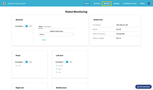

Once you’re on the dashboard (if you need a reminder, go back to the previous section):

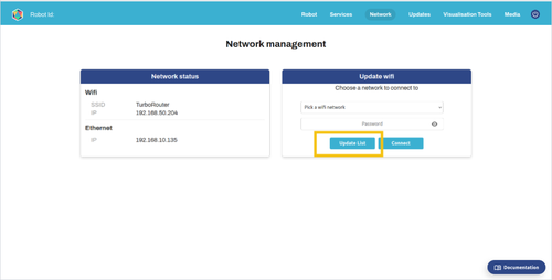

  1. Go to the Network section and click on Update List.
Network section in dashboard
Update Wifi List

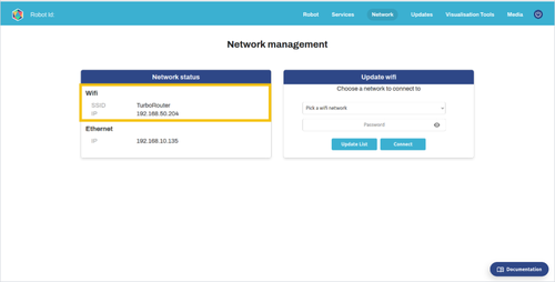

  1. Scroll through the detected Wi-Fi networks in ‘Select a network’ and select the one you want. Then add the password and press Connect.
  2. Check that your new connexion appears :
    New Wifi IP address
