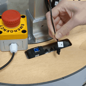

A) Plug in the Emergency Stop Button
Plug stop button
Connect the emergency stop button to one of the black connectors (A) on the mobile base.

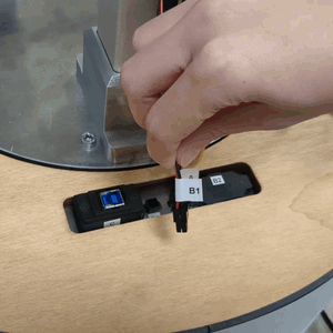

B) Connect the Battery
Connect battery
Make sure the emergency stop button is pressed.
Plug the black and red wire (B1) into the mobile base. Then plug the yellow connector (B2) of the mobile base so the robot will be powered when the emergency stop button is released.

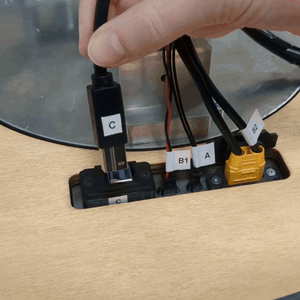

C) Connect the Mobile Base to the USB Port
Connect USB port
Connect the USB cable (C) coming from the mobile base.

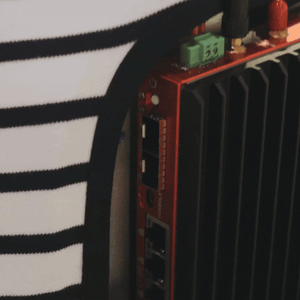

D) Connect Reachy to Your Network
Plug ethernet cable
Plug the Ethernet cable from Reachy’s computer (Ethernet port n°1) to your router. It allows it to be accessible on your network.
