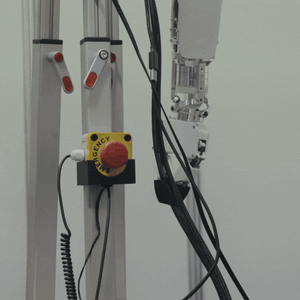

Then press and turn the emergency stop button clockwise to raise it. The automatic calibration process will start.
The robot is going to move slightly during the calibration process. Do not touch the robot, and make sure the arms do not encounter any obstacles (tripod included) during its movements.

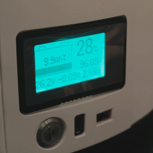

Press the button located on Reachy’s back. It takes up to 2 minutes for the computer to start. You will hear a little bubbly sound when Reachy is ready.
ℹ️ On the latest robots, the button is located on the right side of the robot torso.
