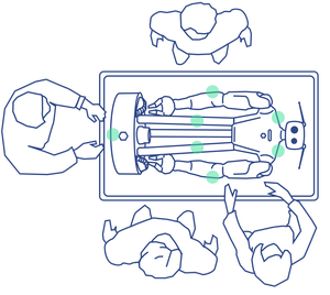

B) Lift the Robot Out of the Box
Reachy 2 weighs 50 kg; it’s heavy, so make sure you have at least 4 people. Position people around the box as shown below.

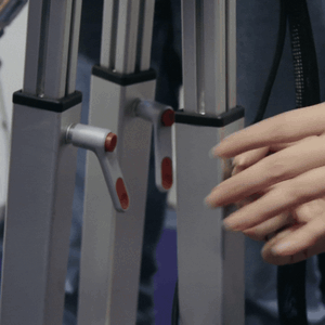

C) Adjust Robot Size
Adjust robot size
Hold down the mobile base and ask someone to unscrew all pods (not too much, 90° should be enough), and lift the robot’s torso to adjust the height. Make sure Reachy’s head is straight and arms are far from the tripod.
