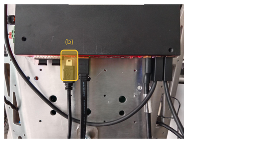

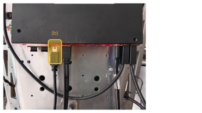

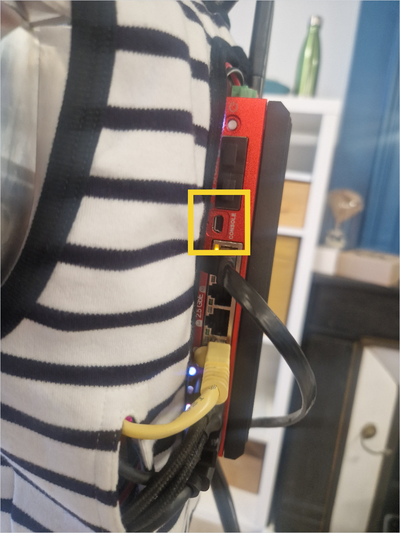

Use the appropriate cable and connect your computer directly to Reachy 2’s computer. The cable has to be plugged in the console port of Reachy 2’s hardware interface.

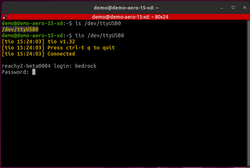

Serial connection port
We use tiofor the serial connection. If you haven’t installed it yet on your computer: apt install tio
Then, in a terminal on your computer, get access to the robot with:
tio /dev/ttyUSB0
and press Enter.
Note that the connection could be on another USB port. Check all ports with ls /dev/ttyUSB*
tio connection terminal
Once connected, open a terminal on your computer and run:
tio /dev/ttyUSB0
Note that depending on the elements you connected to the robot, the port could be something else than ttyUSB0. Check other available serial ports with ls /dev/ttyUSB*
Tio connection port
You are then connected to Reachy 2 computer!
