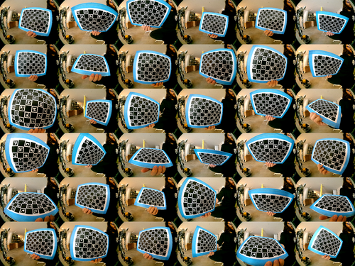

2. Get some images
Connect the teleop cameras to your computer. You simply have to disconnect the teleop cameras USB connector from the robot’s computer and plug it to your computer instead.
If it is your first calibration, you must add the udev rules with:
echo 'SUBSYSTEM=="usb", ATTRS{idVendor}=="03e7", MODE="0666"' | sudo tee /etc/udev/rules.d/80-movidius.rules
sudo udevadm control --reload-rules && sudo udevadm triggerThen, still in pollen-vision/pollen_vision/pollen_vision/camera_wrappers/depthai/calibration, run:
$ python3 acquire.py --config CONFIG_IMX296
Press return to save a pair of images in ./calib_images/ (by default, use --imagesPath to change this).
Try to cover a maximum of the field of view, with the board in a variety of orientations. If the coverage is good, about 30 images is sufficient. Also, make sure that most of the board is visible by all the cameras for all the saved images pairs.
Below is an example of good coverage:
