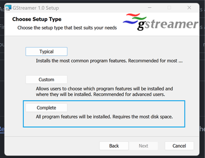

GStreamer installation
Select the Complete installation for gstreamer:
