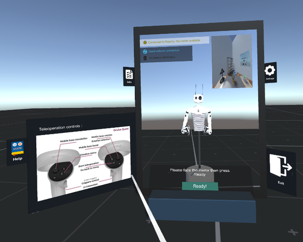

  3. Once in the mirror room, you can configure various settings. Take time to tune the motion sickness effects you want to use in the settings menu. When you are ready to start, press “Ready”, then hold (A).

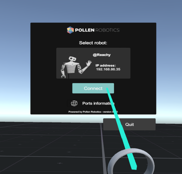

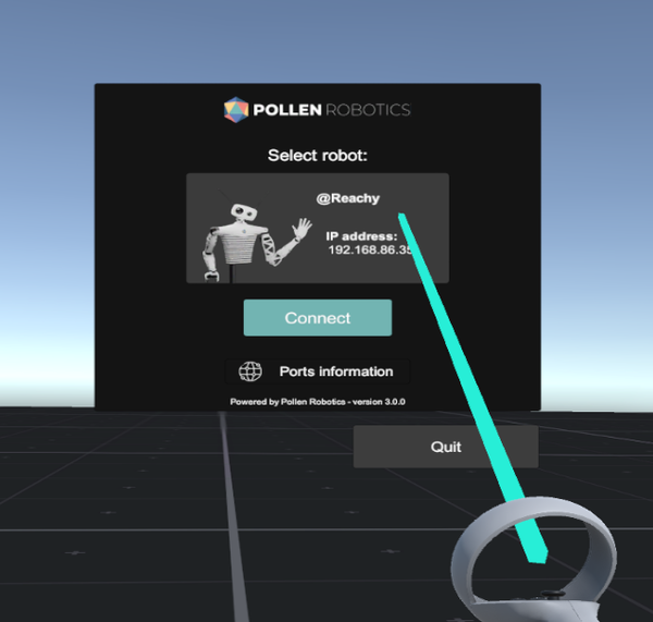

  5. Choose the robot you want to connect to: you can select a robot with its IP address, or add a new one to the list of available robots.
Change robot to connect Select robot to connect
  1. Press Connect to initiate the communication with the robot.
Connect to a robot

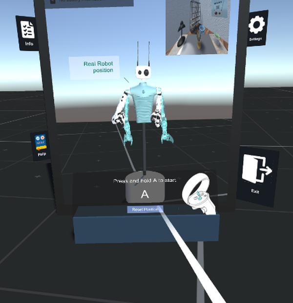

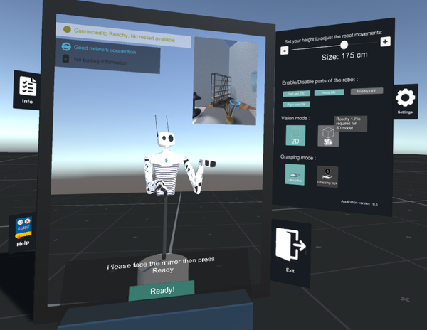

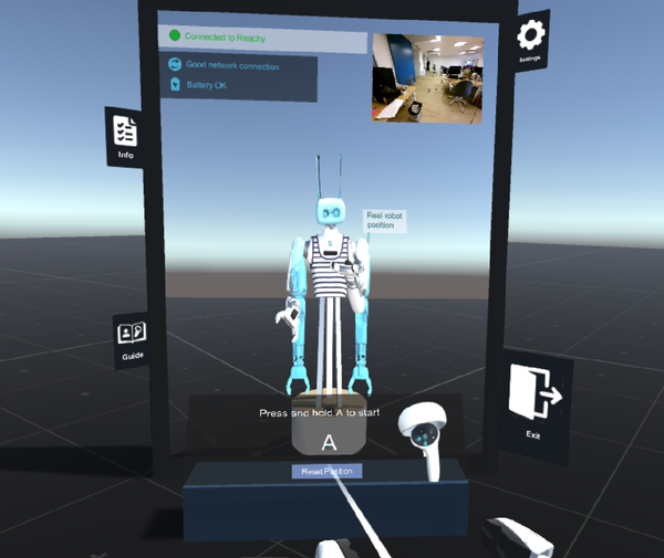

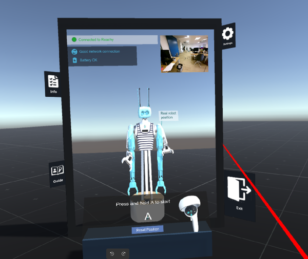

  1. You should be now in the transition room, and see yourself controlling a virtual reachy. The actual robot is not in control at that time but the live camera stream is displayed at the top right of the mirror. The info, help and settings menus are available here (they are documented in the next section). Please get familiar with the robot controls and features (emotion, grasping lock).
Mirror scene

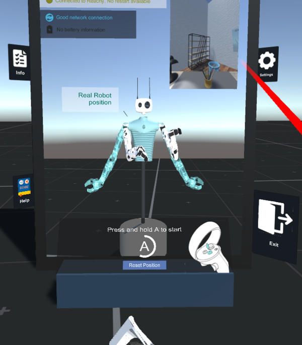

  1. When you are ready, face the mirror completely and click on “Ready”. The position of the actual robot appears in a semi-transparent green color. This may be useful when you’ve left the robot in a certain position that you would like to keep when entering the teleoperation. Hold (A) to start the teleoperation.

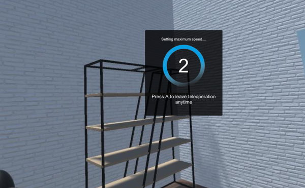

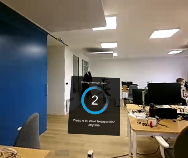

  2. A 3 seconds timer appears while you enter the teleoperation. The motors speeds are reduced during this time to avoid sudden movements of the robot. Full speed is reached at the end of this countdown.

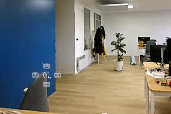

Use Reachy’s emotions
Bring Reachy to life with antenna movements! It can express four distinct emotions using its antennae: happy, angry, sad, and confused.
To trigger an emotion during teleoperation:
  1. Press the X button on your controller.
  2. Use the left joystick to select the emotion you want.
Emotions panel
The animation will play for a few seconds, adding expressiveness to your robotโ€™s interactions.

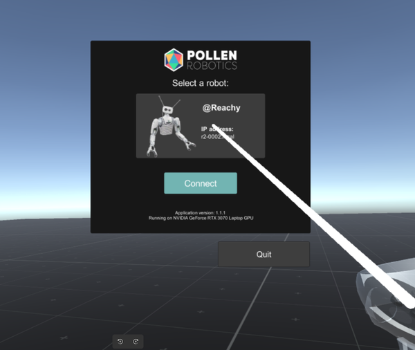

Connection page

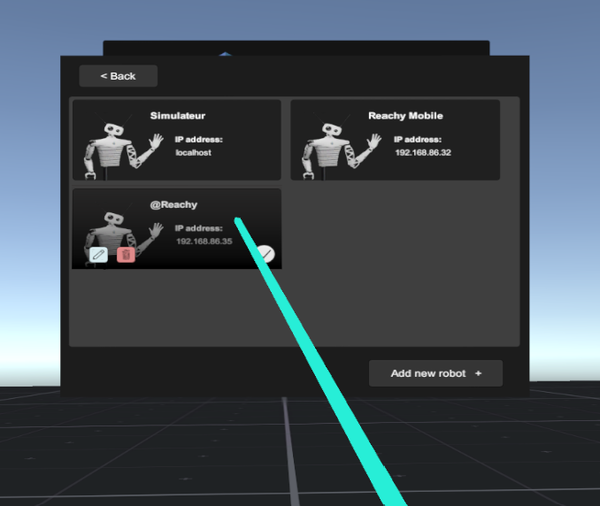

Click on the robot to select to open the panel of all saved robots:

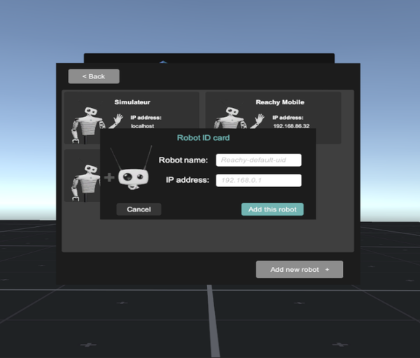

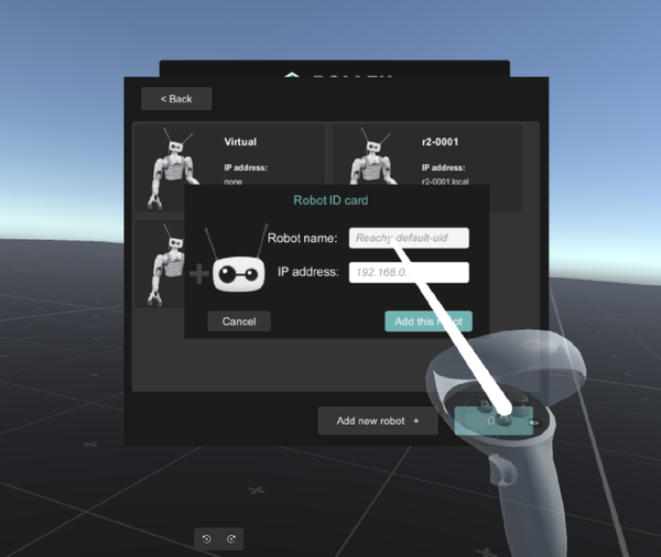

Then click on “Add new robot +” at the bottom right of the page:
Add robot button
Enter a robot name and the IP address of the robot (if the headset is connected on a computer, use the computer keyboard), and save your robot card:
The IP address is mandatory. If no name is given to the new robot, it will be called @Reachy by default
Add robot panel

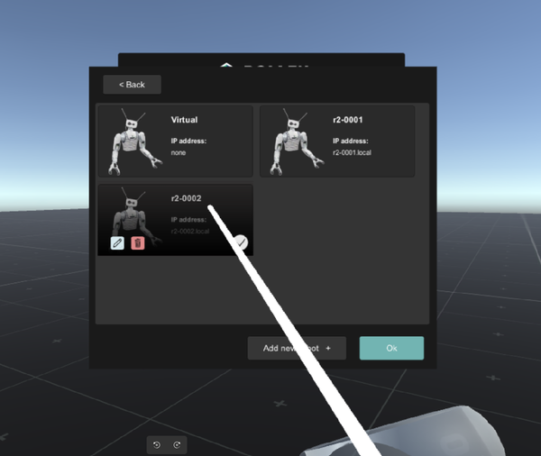

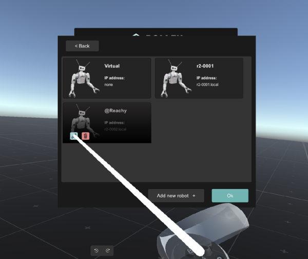

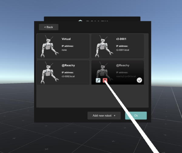

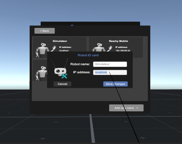

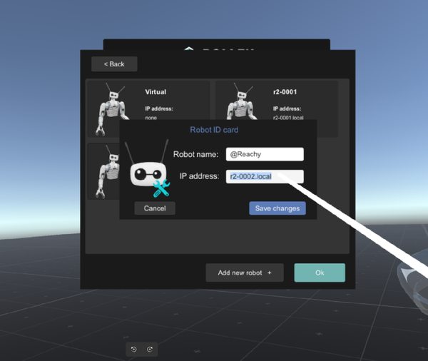

Then click on the pencil icon of the robot you want to modify:
Modify robot button
Modify the info on the robot card and save the card:
Modify robot panel

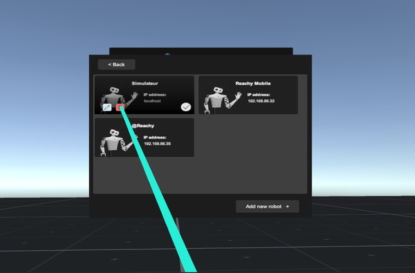

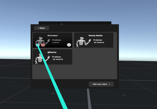

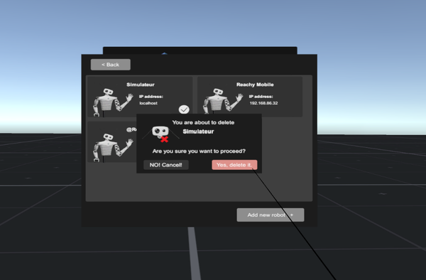

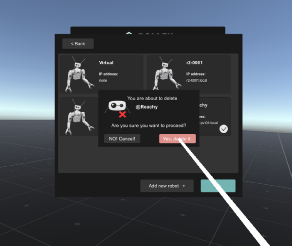

Then click on the bin icon of the robot you want to delete:
Delete robot button
Validate the deletion:
Delete robot panel
Mirror scene

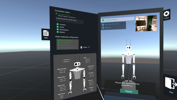

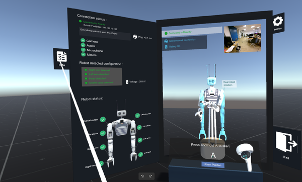

Open the info menu in the mirror room:
Info menu
The connection and services status, and motor temperature are reported here.
Open the help menu in the mirror room:
Info menu
The mapping of the controller buttons to the robot actions are displayed here.

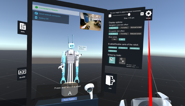

Open the settings menu in the mirror room:
Settings menu
Here you can set your size to improve the mapping between your movements and reachy’s motion. Individual parts of the robot can be deactivated in the case you don’t need the mobile base, a specific arm, etc.
Motion sickness options are available in this panel: choose to display a reticle or not, and select a navigation effect that fit to your robot use. You can also modify the grasping mode there: with full control you decide at each time the opening of the gripper, while the grasping lock option enables you to close the gripper with on trigger press and open it with another one. Grasping lock option can be turned on/off as well in the emotion menu.
While facing the mirror, your body should be aligned with Reachy’s body. This is mandatory to have a consistent control. If this is not the case after having pressed “Ready”, face the mirror and click on “Reset position”.
Reset position
The “Reset position” button is placed at the bottom of the mirror, under the A loader.

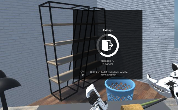

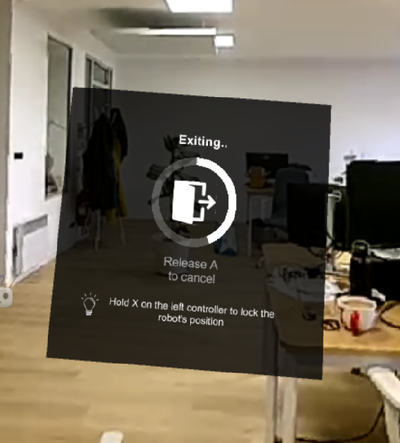

Teleoperation exit
While press (A) to exit the teleoperation, you may hold (X) to activate the position lock. A lock is displayed when doing so.
Exit and lock
The robot will stayed locked while you’ll be back in the mirror room. This can be useful to keep a certain position while you need to take a break, change position or remove the headset. The position of the robot will be displayed by the semi-transparent green robot when you will restart the teleoperation.
